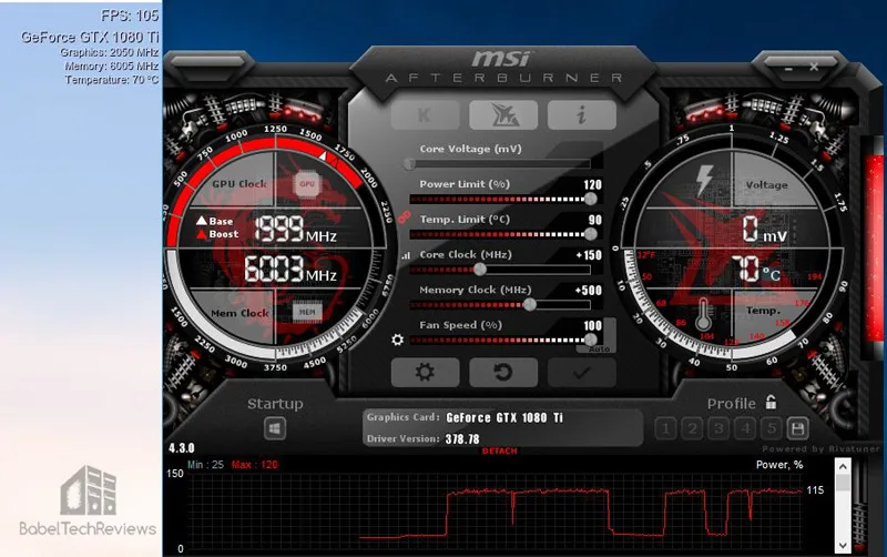

GTX 1080 Ti Overclocking
We found overclocking with the GTX 1080 Ti to be very similar to overclocking the TITAN X with the exception that the faster vRAM that the Ti uses is much more overclockable.  We were able to add 150MHz to the core and a 500MHz offset to the memory with complete stability through all of our testing on very hot days with the result that we reached a steady 1999MHz core and 6000MHz (12000MHz) memory clocks.
The GTX 1080 Ti’s fan profile is similar to the TITAN X’es and the GPU generally stayed under 70C with the fan at 100% and the noise level is similar to the TITAN X noise level.
All of our games were benchmarked at these respective overclocks with complete stability.
